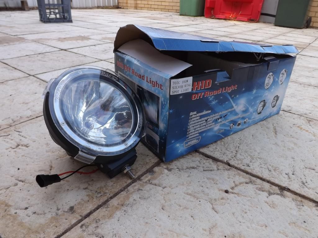

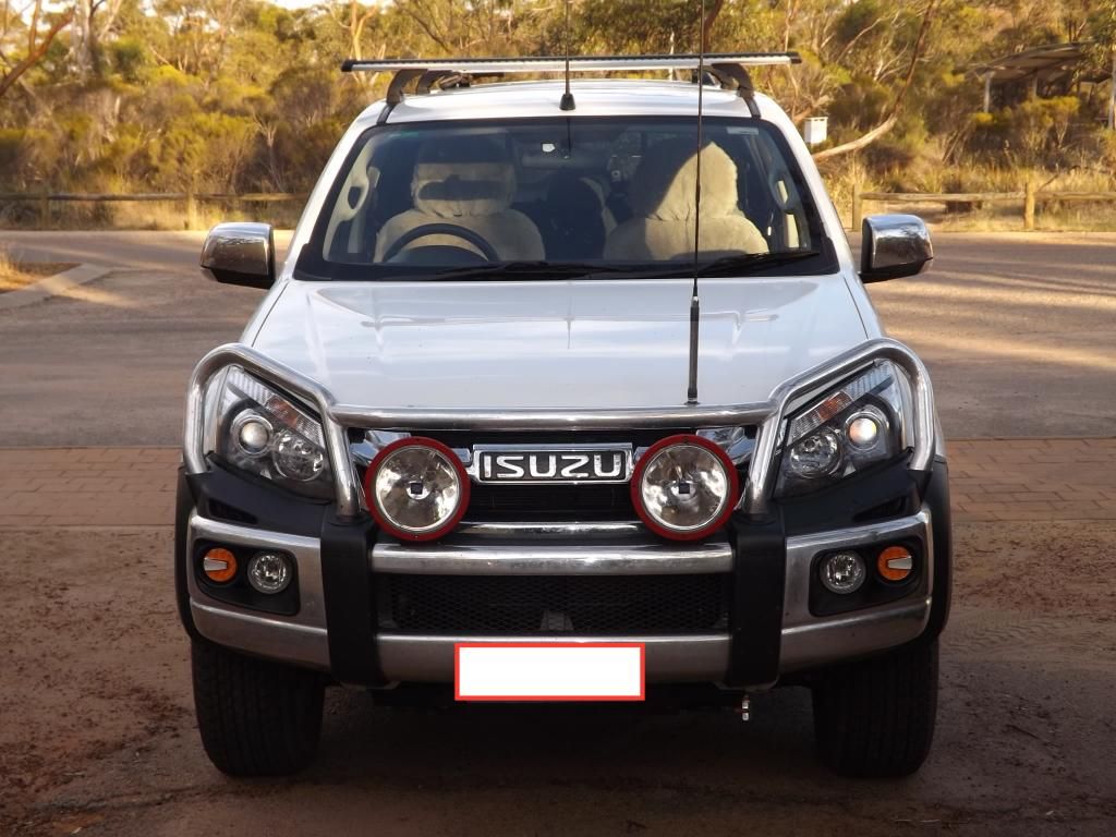

Bought a set of these HID’s after they were recommended by a fellow member, thought I’d see what the 100w ones were like....turns out the body is too deep for the OEM bulbar.....Image

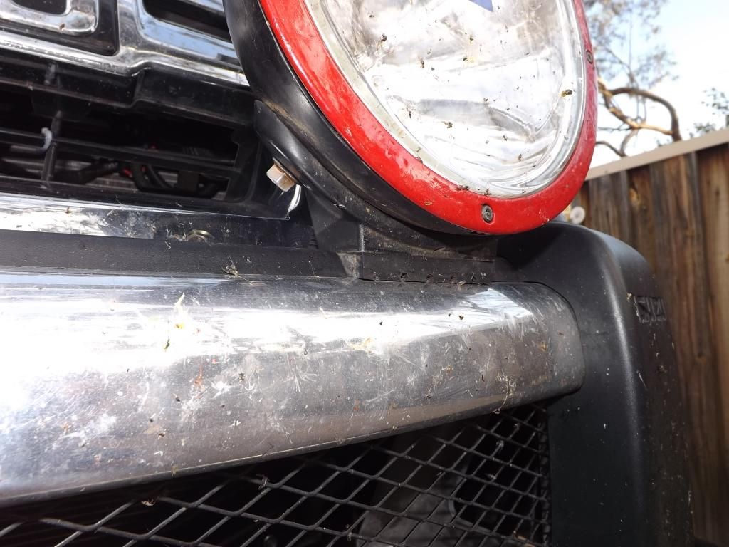

so I changed tack and bought a set of Hella rally 4000’s, still had to do some creative work with the die grinder to elongate the existing hole in the bulbar... added a spacer block underneath AND enlarged the adjustment space in the body of the light....nice lights though....

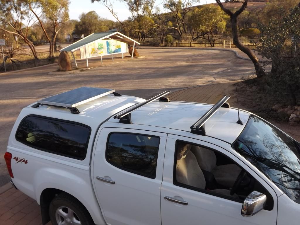

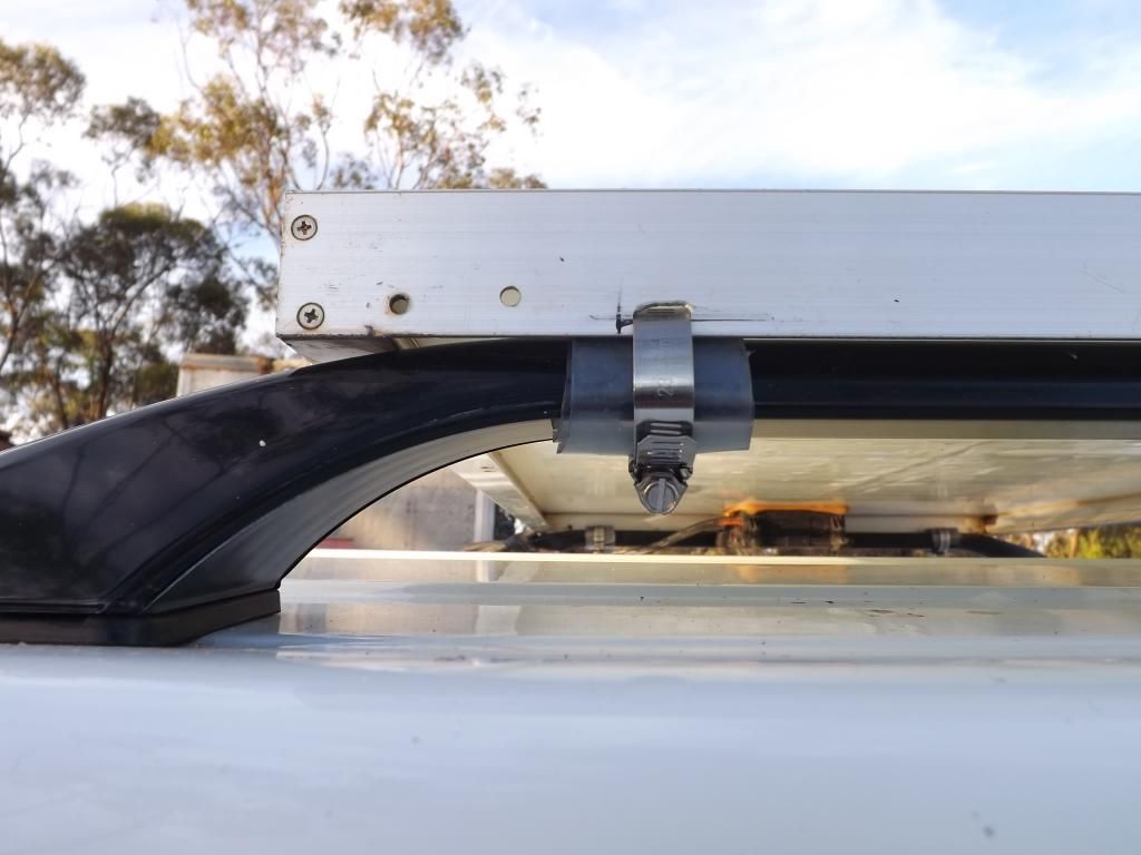

Fitted the Prorack H/D Whispbars as I have decided to fit the RTT over the cab instead of the canopy..... also fitted the solar panel as well after an excellent tip from a forum user, fits just perfectly across the rails on the canopy....

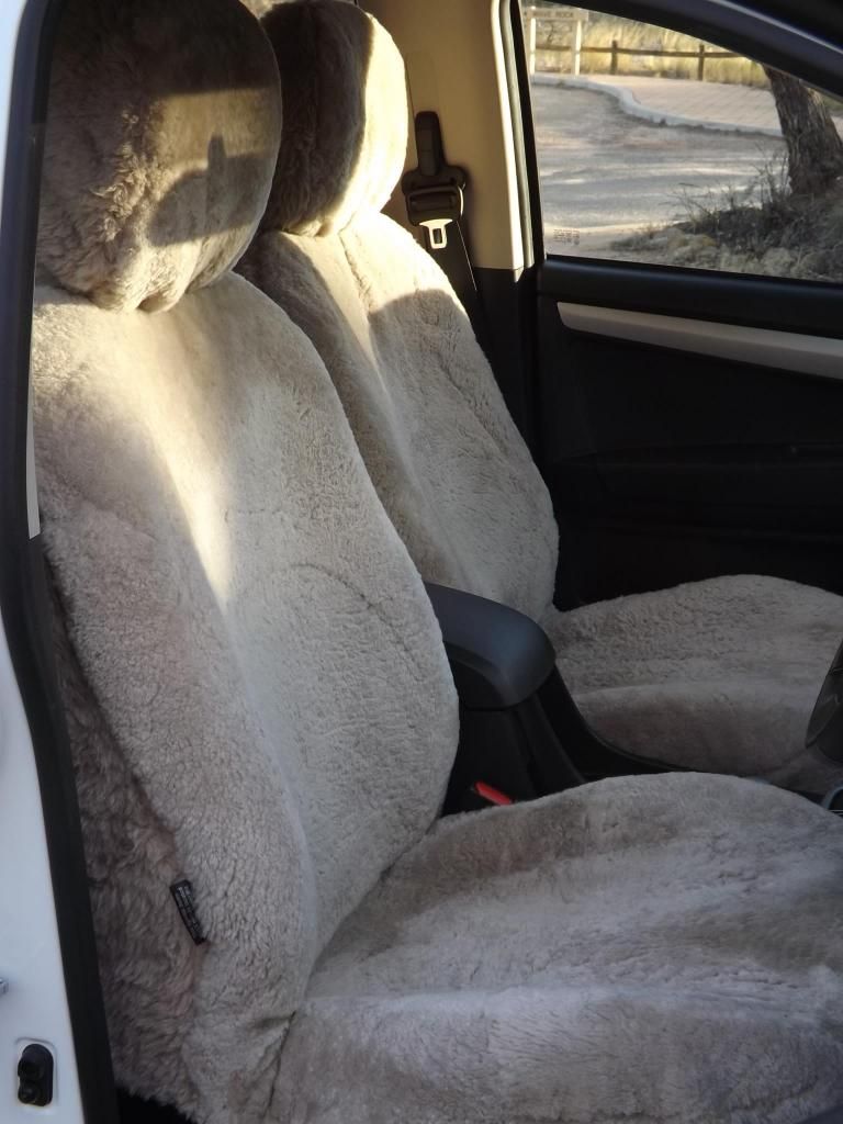

Seat covers done......went for the Deploy Safe Adventure model..... in Mocha to take away a bit of the black/grey from the interior

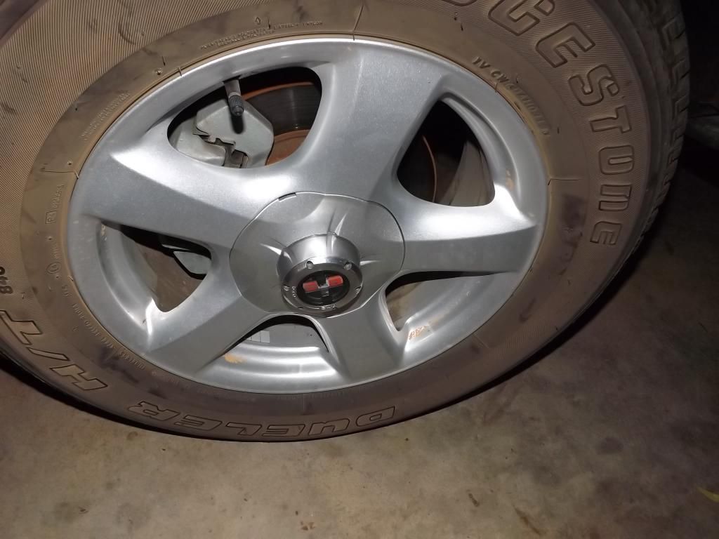

Free Wheeling Hubs fitted.... used an 86mm hole saw and then about ten minutes with a half round file to get a nice fit around the lip of the chrome outer section..

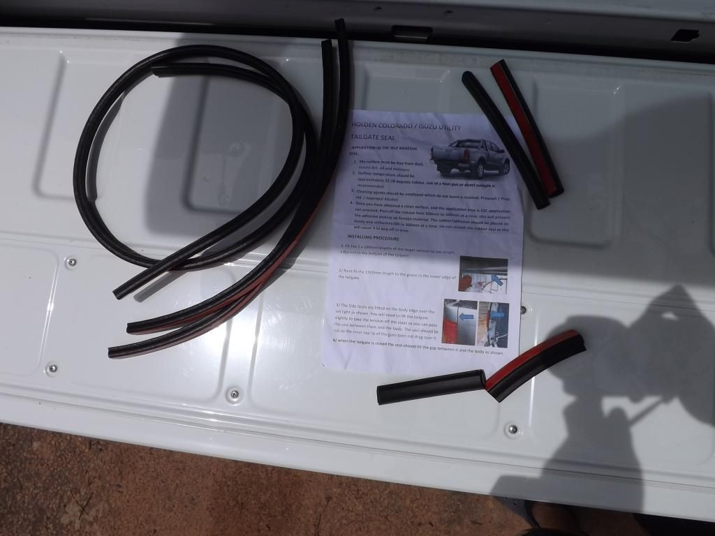

Provent 2000 fitted, fixed L/h window on canopy, turned gas struts on canopy up the right way, fitted tailgate sealing kit (seems to work well but I need to added a piece of seal where the upper hatch meets the tailgate)

Like your method of mounting the solar - very similar to what I did (viewtopic.php?f=17&t=960) :lol: :lol: :lol: :lol:

It has probably been said but i am lazy what is the benefit of converting the front hubs to the manual ones ???
_________________
I come from a land of Bintang Singlets HSV's and 50 dollar Lobster known as Perth
Top
 Profile
 Post subject: Re: Jim & Leona’s DMax
PostPosted: Wed Dec 10, 2014 11:12 am
Offline
Joined: Wed Aug 20, 2014 2:27 pm
Posts: 382
Location: Brisbane
Front Hubs discussed at length here: http://www.newd-max.net/viewtopic.php?f=4&t=340
In a nutshell; the aim for most here is to disconnect the front wheels from front diff/shafts, so they don't turn all the time, particularly when in 2wd mode.
